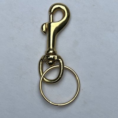

I wrapped electrical tape over the tailgate lock and Panic buttons. It's not a full fix, but it now takes more pressure to push the buttons and do something unintended. I also just started hanging my keys/fob on a brass clip from my belt loop. Keeps them out of my pocket.
