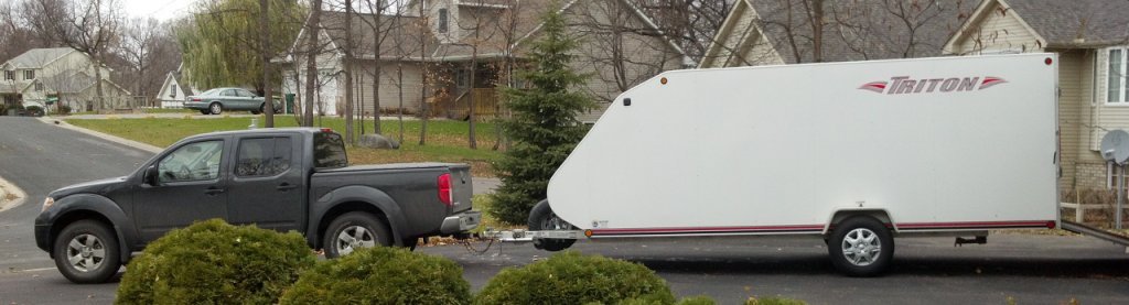

As others have said you definitely don't need an HD truck. I have a 16 foot enclosed snowmobile trailer. With two sleds in it it's about 2700# so just a bit lighter than your boat. I used to tow this with mid-size trucks - first a 2013 Nissan Frontier 4.0 L and later 2019 GMC Canyon with 3.6L. Those trucks were really good mathes for this trailer. I only went with a Sierra 1500 when we got a travel trailer that was 6K# loaded and went with a Ram 2500 Hemi wh3nnwe moved up to a bigger trailer that's 7600# loaded and 8736 GVWR. For your boats weight a 1500 can do it easily.
