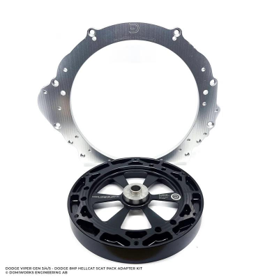

A few people have asked. This adapter is for the viper v10/srt10 to dodge 8hp. I have at least one customer using this successfully in a srt10 truck with a stock 8hp70 with my kit for the electronics. This adapter should also work with the Cummins diesel engines if you want to try that out. My understanding is the bolt pattern is the same from some research I have done this morning. If the Cummins truck is a newer one with CAN. LIke 2008 or whatever we should even be able to communicate in the production truck similar to the way we do the Nag1 and RFE swaps with gas cars and trucks. I do not know a ton about the year to year differences in transmission controls on the Cummins trucks but I know they had different separate TCMs for quite a while on the RFE and the Aisin. I am happy to answer what I can about these projects but I have not personally executed this so as with anything it is always a bit of trial and error when doing new things
Nice to see he's collabrating a bit with Domiworks
