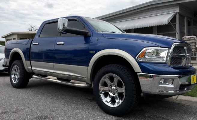

Those who have swapped out 20" tires for towing
Did you check that the stock 20" rims could take 80psi?
I wouldn't run them at 80 on a half ton. No need. 50-60 will be enough.
Here's mine at 50 loaded heavy and no to minimal squish.
