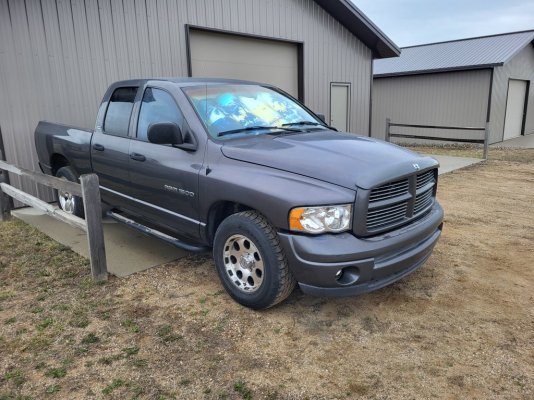

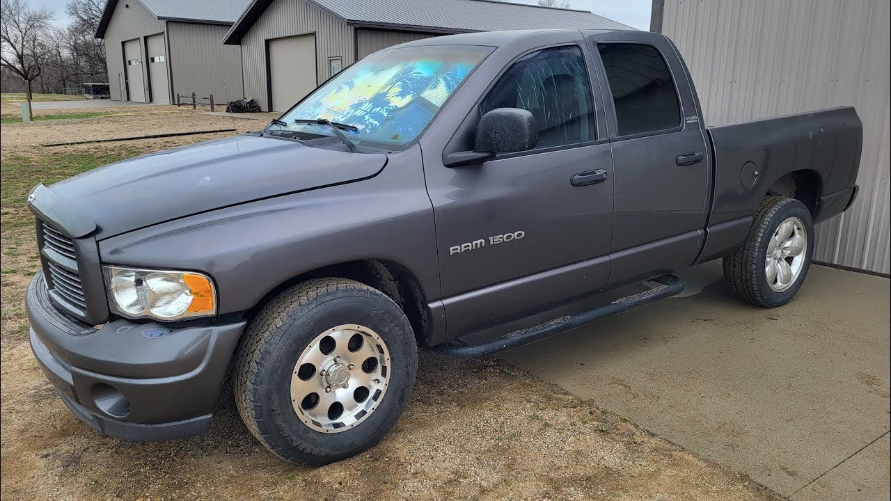

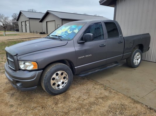

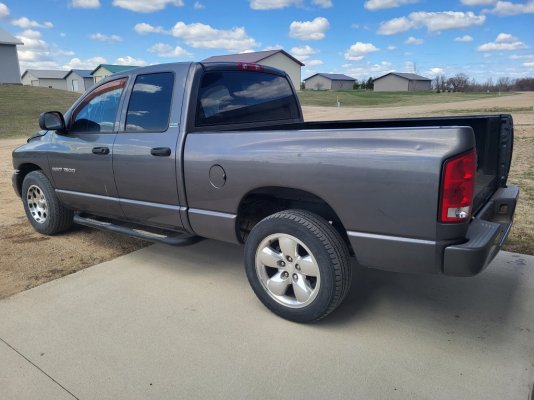

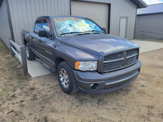

Im pretty sure its rod knock. I just dont have the time right now to fix it. I swapped the rust free box with my single cab last week and Im just going to sell the truck as is.
Since box was swapped, has minor rust over rear wheels but rest is rust free from florida if anyone in the midwest is interested in it. Open to offers.
Interior is nice except cracked up dash. comes with an oem nice skin I have for it. Will come with a matching set of wheels and tires. Not shown in pictures
