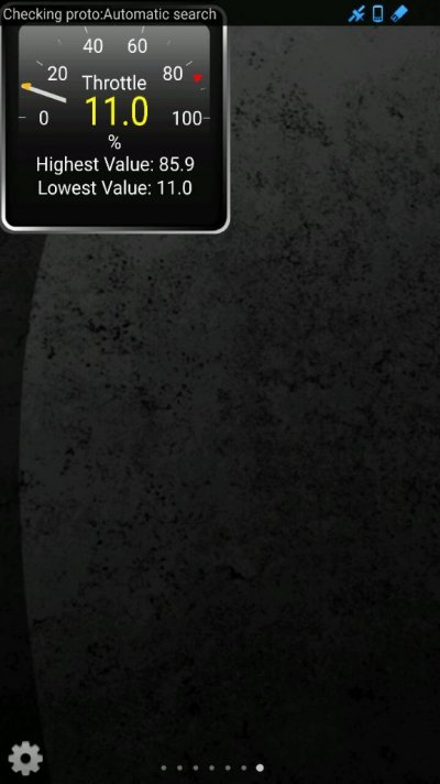

Anyone else using torque app or have a tuner that shows throttle usage? Mine is only showing 86% and I'd really like the additional 14%
I've tried the old method of calibration, key on, no start, 3 full throttle presses, key off and it's still the same.
Any ideas?

From what I was told it'll never show 100%. Asked that when I first bought my tuner. Highest I've seen for my THR Blade is 76% and some change.

The TB is already at 24% when fully "closed" ? we've all looked at a TB, right? even an old carb...the blade never sits at 0 deg, there is alwasy some angle, even when the engine is not running.
also its possible:
76. XX % is = 90 deg.
The blade has an initial angle of 14 deg when fully closed, and the 76 % is actually degrees and, well 14 + 76= 90
Maybe thats it, the % is actually degrees.
My car tuner never did answer that particular question or many others either.
Maybe Hemifever can enlighten us.
then again this may be of no consequence to tuners, in thier ability to tune.

Ive ran the torque app on a few different cars and it seems the ones without a throttle cable show 76 -86%. My wifes cavvy shows 100% @ WOT so that throws most of the theorys out the window... Though my newer car shows 86%. So it's just showing the wrong sensor
I dont think your wifes Cavvy? changes anything in this discussion. different OEMs use different paramaters/ math for thier factory tuning. 100% could simply be 100% of the available travel:
76 deg + 100% of the avalailabe ( parameter) range.

Hopefully Chris will come back and tell us the real answer but I imagine that it is able to achieve the desired air/fuel ratio by only opening 86%.
