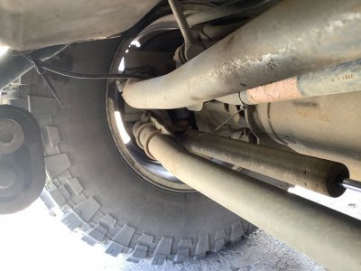

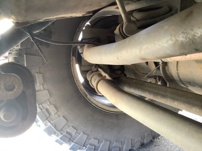

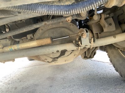

Hey all,
Just installed a set of Timbrens in the back yesterday to help the squat when hauling 1000+ lbs.
( always 400 lbs with the ramboxes and a quad and trailer )
Unloaded test run was a success.
Loaded test run will happen next week end ( 17-18 )
I'm not convince it's the best way to go since they're gonna be articulation lost but I'll try anyway.
And for the Dampers, just wow.
Installed them a couple of weeks ago and I can feel a good difference.
I had trouble with front wheel wobble when going 90 KPH ( 55 MPH ) with a tongue weight slightly turning left.
( this happens since a tire rotation so I guess I should rebalance the tires )
No more wobbles and steering is more solid/stable.
I'm posting this since there's not many Powerwagons with Timbren and why not include the dampers.

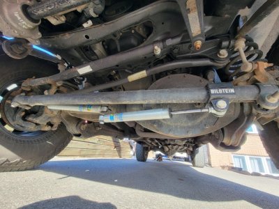

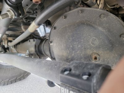

I like your dampers I have them to but I used a synergy steering links the billstien mounting bracket won't fit around the link.you have to use synergy bracket and the eyes sleeves have to be ground down to fit in the bracket. grinding on a 200$ shock is not what I call good but the teck at 4wheel parts said thats how they would do it.

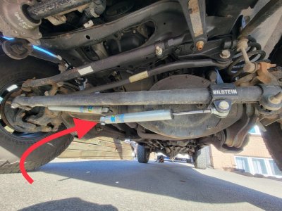

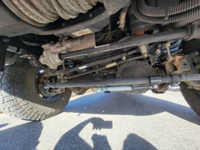

Could the drivers side steering dampener be installed on the top side of the other shock for better clearance?
Why I am not surprised that you grinded a 200$ damper lol!
Sometimes you have to make it happen

Gotchya. This pic you posted just makes it look like its hanging way down, but its probably not as bad as it looks i guess. But, seems like at the red arrow you could mount the drivers side shock on the top, and spin the mount on the bar to the top as well...but like you say, might be clearance issues.
The dampers are pretty much straight. That pic made them look really crooked.
Well, now you make me want to try it the other way.
I might get to it next week. 30 min work and some testing.
I'll keep you posted

the reason I use dual stabilizers is because I don't want problems away from home or in the bush with the missus. I don't think she would like the walk home.. also I didn't like the mfgs solution to the safetyrecall on the adjuster in the steering so replaced all that crap serviceable end links is only part of it.if it looks like that the one stabilizer is on an angle its because it is it has to be that way for clearance
