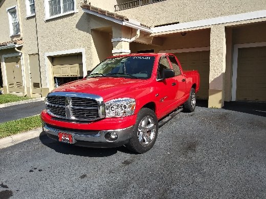

Just had my engine replaced for 3k
Out the door!
Down in hiealeh florida
2006 ram quad 147k miles
Prob need a tranny soon?
But hey its better than a payment...
Left everything stock
They specialize in hemis and advertise 2.5 k to replace
But i needed ? A water pump and a couple of other things?? Whatever i didnt care heck its only 3k for a brand new rebuilt engine right? Installed! btw
I live in so fla so i replaced the radiator
3k for new engine
1k for paint
500 for lights and carpet and radiator...
Cant beat that with a dead ford emblem!

Not bad at all. What sort of warranty did you get?
