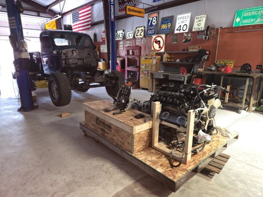

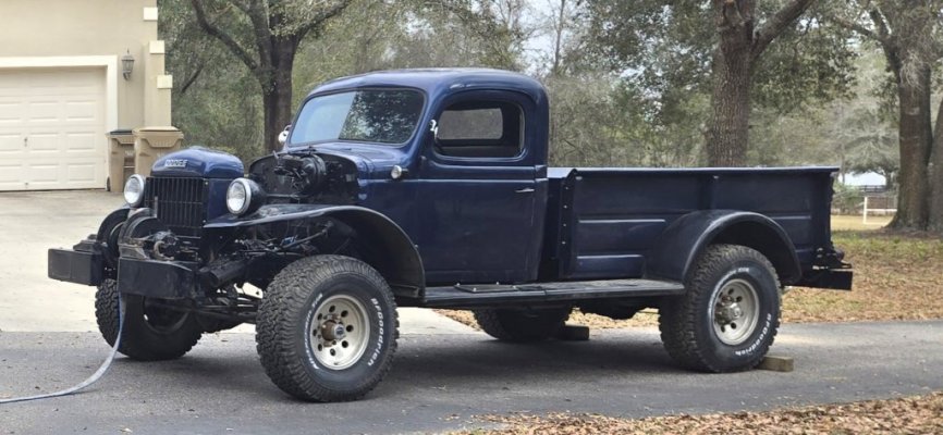

Looking to install Hydraulic Power Steering Pump on 2022 Ram 5.7
Fabman
Nov 6, 2020
46
50
East Coast
I am building a 1955 Power Wagon. Installing a 2022 Ram 5.7 w/ 8HP trans. I need to install a Hydraulic power steering pump on this engine as the truck it came out of had EPS. Anyone point me in the right direction for engine accessory configuration for this hydraulic pump? PICTURES would be very helpful....and attached see a pic of the new Project..

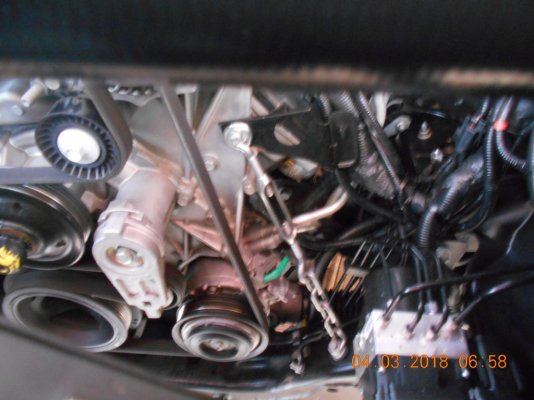

What I was hoping for was Pictures of some of the earlier & even the newer accessory drive setups on the 5.7 Ram engines. I know the accessory configurations / locations are different on some models and I was hoping to actually see the different setups.
Google is your friend ,you should be able to find lots of pic's of the earlier set-up.I don't have any good pics of the front drive,these are the only 2 i have of my 14's front drive.
