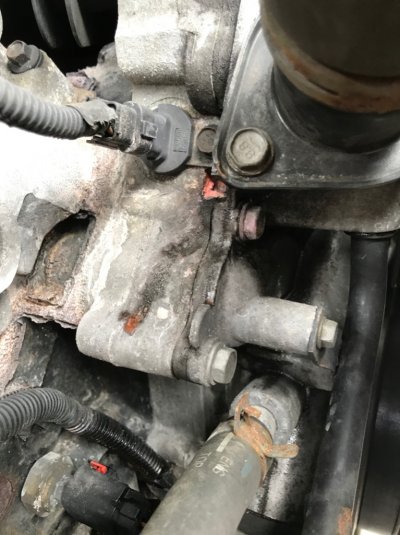

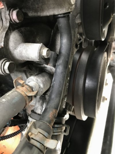

After doing some tinkering today, noticed a slight bit of antifreeze on the front cross member. Did some snooping, found a couple runs from around the T-stat area and the water pump. Thoughts?7bf1728286b364f30d55f23b991cf363.jpg f0f464c0a22d4ce468556874a5e20f92.jpg759a2a45c0e5802f9802e0be21bb4658.jpg

Yep, time to replace it.

2010 1500 with 92k. After some further research, looks like the coolant temp sensor is leaking just slightly. Gonna try and tighten/replace the sensor first. No issues with the fan clutch, pulley lose, antifreeze coming from the weep hole. So gonna start with the easiest thing first
