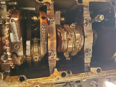

Okay, guys, I know I promised pictures of the oil cover gasket change and while I’m at its that I did. A quick review of the issue leading up to the work done can be found here – https://www.ramforum.com/threads/found-the-leak-gonna-fix-it-but-what-else.157650/

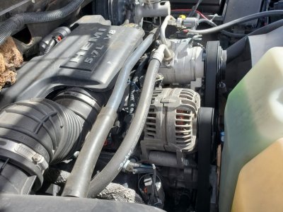

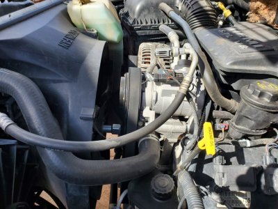

So, without further delay, here are the photos. These first few are just some reference photos; you can ignore these if you like.

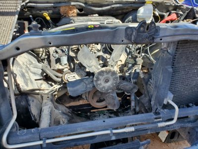

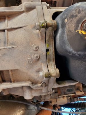

So it looks like the leaking coolant made it all the way to the back of the engine.

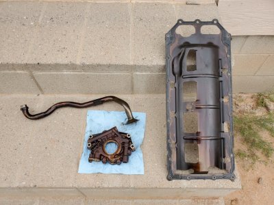

- Felpro, Oil Pan Gasket, OS30750R, $39.79

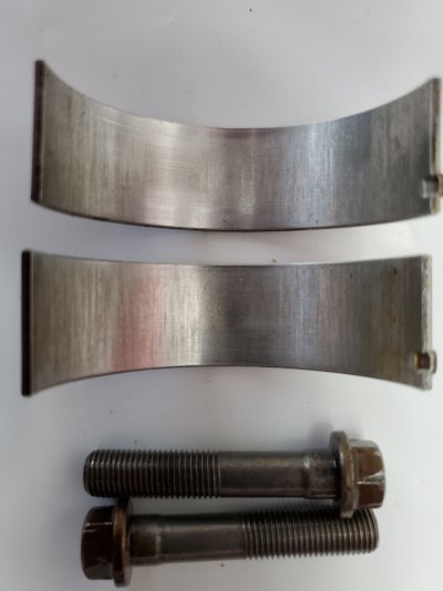

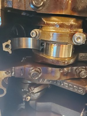

- Mahle/Clevite, Connecting Rod Bearing, Standard Size, CB1808P, $6.15 ea, $49.20 total

- Melling, Oil Pump, M342-375S, $93.79

- ARP, Rod Bolt, ARP-2476301, $121.99

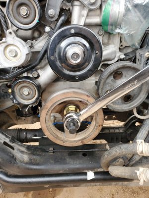

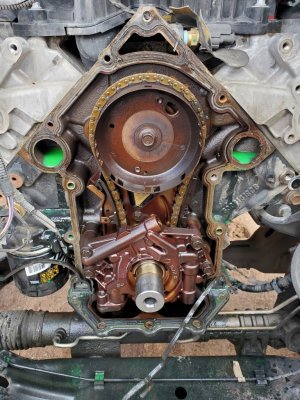

- OEMTOOLS, Long Reach Harmonic Balancer/Pulley Installer, 27306, $43.69 (nobody had this to rent or sell locally and none of my family or friends had one I could borrow).
