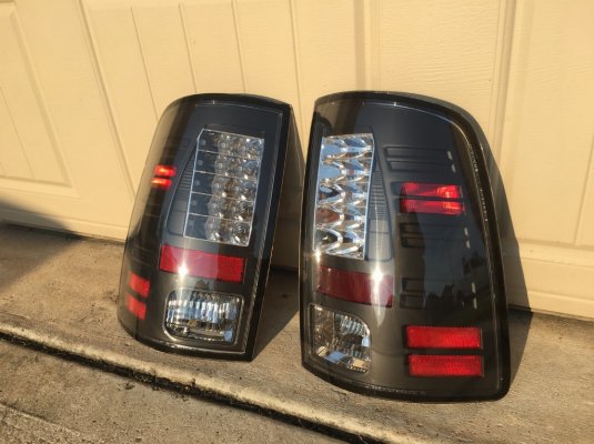

I took some black clear tails and took a stab at tinting them red, to me they resemble the look of the OEM RT tails
Here is the before...
Using a vinyl fine line tape i blocked off the reverse light section and laid down some red tint

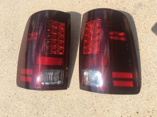

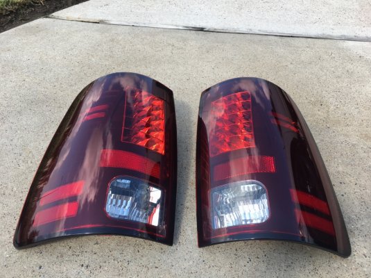

Then removed the tape and cleared the whole light (you can see they still need the final sand and polish to be shiny enough)
Here is the result of the taping and me guessing at the actual shape of the reverse light
Then the final sanding before polishing
And after they are polished up...

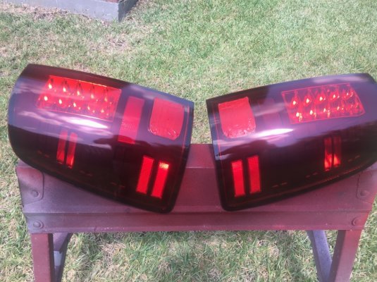

What do you use to tint red? Interested in trying!

VHT makes a red tint

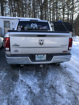

Demon-Hemi, Those came out awesome. LQQKS like factory to me. I actually went with the Spyder Red Lense Taillights.IMG_0668.JPG

Yeah, forgot to say they liked good af. But seriously, how many coats? ((and can you please check PM's when you get a chance?))
Sent from my magic 5-inch
When i do tinting, i dont paint in coats, i paint by feel so to speak, its a tint so you have to tint for coverage or desired effect, so i really dont have an answer for you, when it comes to tinting lights you just have to experiment to see what gives you what you're looking for
