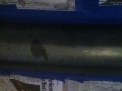

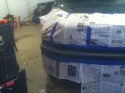

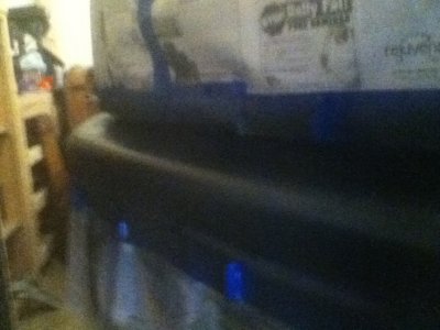

I plastidipped the pad on my front bumper and so far its help up great, also did the rear but don't have pics. This the setup for it, first pic is a wet spot to show contrast of when its wet vs dry (before plastidip btw) hard to tell in later pics, I can get more tomorrow tho if you'd like

just like painting, prep work is everything. With plastidip you don't have to primer or anything like that but the surface has to be clean (common sense) and try to make sure you mask off what you don't want done. Yes it comes off fairly easily with a sponge but I didn't feel like scrubbing my already bad paint lol

just be careful that its only been drying the final layer like 5 minutes when you start pulling tape off as it REALLY helps make sure you don't peel it up with the tape. Also, don't do this without adequate ventilation, and I mean adequate. I spent 6 hours nitpicking mine with both garage doors open and I'm pretty sure I'm going to get cancer at an early age lol :smokin:
