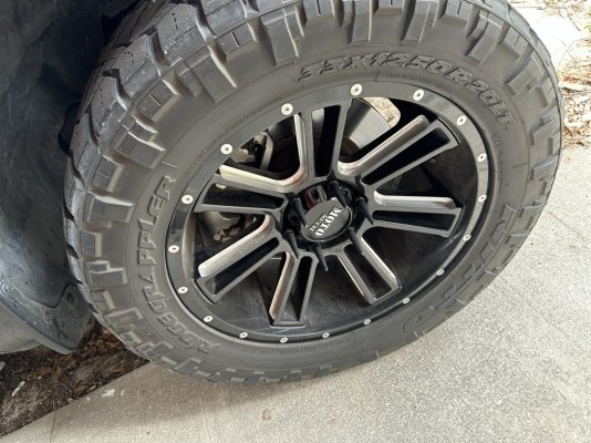

I am wondering if someone might be able to assist me. I bought my 2020 Big Horn with beefy tires. I love the look but the ride at 80mph leaves a bunch to be desired.
My current tires are 33x12.50R20LT
Any advice on new tires that are more "all season"? I do not do any offroading except for the occasional Florida sand road once every 6 months. Just need a good tire that is all season, good in rain and preferably a bit quieter than current.

I am assuming those are on an unloaded 1500. My bet is you are packing WAY too much air pressure. Air your existing tires down to about 35-40 lbs each. Ride will improve greatly.
I will check them tomorrow. I know I put them higher than 40 due to my research. I do not tow or anything so yea unloaded.

Here is a tire pressure chart for your exact tire. You can find any tire size and make pretty much on this site.
Assuming your 1500 weighs about 6000 pounds with you in it and a full tank, your inflation pressure should be 30-35 PSI. The tire pressure is based on the corresponding pounds of weight on each tire.

I cannot read what the load rating is on your existing tire from that photo. LT tires commonly come in E, sometimes D or C.
A 1500 factory tire is most often a P rated tire, or maybe a C or D. As you go up in weight capacity and the carcass gets heavier the ride gets more harsh.
If you’re running empty and prioritize a smoother ride then look for a P or LT-C rated tire for a lighter and more flexible tire.
If you start with what is on your door sticker that’s going to indicate a good choice for ride quality and adequate for the weight rating.

Wow, thank you all for the help. I have a clear direction. First thing I am going to do is deflate the balloons lol.
I do love the look of these tires so hopefully the lower air will help with the ride. We have a big 4 hour trip coming up this weekend.
He's running LT tires, doesn't that make a difference vs standard P rated tires? Pressure should be 55F/45R, same as my stock Rebel with LT's with similar (but not the same) size tires.
LT285/70R17/E 121/118S55 psi45 psi

LT just means light Truck Tire. But an LT can be a number of different load ranges. What changes is the load ranges from C,D,E etc. Typically a D tire will have a max inflation around 45, whereas an E will have a max inflation around 65 and F around 80, though some Es carry high max inflation numbers. This does affect maximum load capacity that a tire can handle and you should match your load range to the inflation chart, but long and short, most door stickers carry inflation recommendations based on max GVW to insulate the manufacturer. Few people run their pickus anywhere close to max GVW and thus lower inflation is the proper choice.
I can't see the load range spec or max inflatrion pressure on his particular tire but if he can, that will give him a good idea what load range it is.
From that same site.
Nitto Trail Grappler Tire Pressure Chart​
Nitto Trail Grappler tires come in 53 tire sizes with maximum tire load capacity of 2205 pounds to 4079 pounds and maximum tire inflation of 35 psi to 80 psi.
Nitto Trail Grappler tire load capacity and tire inflation settings may vary based on tire load index / load range. Check Nitto Trail Grappler tire sidewall for more information. Tire inflation and load capacity values printed on the sidewall represent the maximum air pressure Nitto Trail Grappler tire can be inflated to support its maximum load capacity, and not necessarily the recommended tire pressure for your vehicle. Never overload or overinflate Nitto Trail Grappler tires beyond the maximum inflation and load capacity values indicated on the tire sidewall.

wow, you guys are awesome! thank you so much for the advice and tips.. I did lower pressure from 45 to 35... I did notice a difference on the side roads. I have a trip to airport on Thursday and then a big beach trip on Sat/Sun.

LT just means light Truck Tire. But an LT can be a number of different load ranges. What changes is the load ranges from C,D,E etc. Typically a D tire will have a max inflation around 45, whereas an E will have a max inflation around 65 an.
Your numbers are a bit off. Here's a rating chart, The PSI data applies to any tire or size. Tire Pressure Chart
I run my 285x70-17 10 ply, E rated at 40 psi all around
