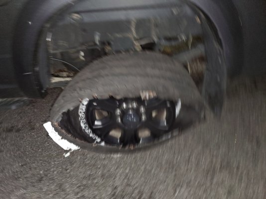

Last night, on the side of I70 with this. Looks like it come apart. 40k miles

That failure is usually caused by over loading , low pressure and some times a bad tire
With the 5yh wheel get the heaviest capacity tire you can and weight the axles when loaded for your trip
full of fuel , water , food and passengers
Nope, none of the above. Just a bad tire.

Four towing you you need a 10 ply. Not your standard load tire
Yup. These were E 10, 125/122R rated. Sad part is in this 40k miles, I didn't really work em hard. Mostly towing my car hauler and on occasion move my 5th wheel camper locally.
But they were OEM, and I planned on replacing them the day I bought it. The tire was good on the road, but lousy in mud and snow.

looks like over heated, under pressured, defect tire all came together.
