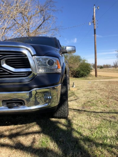

Yeah, I’d have to go search for that wheel offset chart I found a while back to better explain to myself what all that means about what the offset of your wheels but, about how much further out from the wheel wells does your tires protrude after you put those new wheels on? I don’t know if it’ll help much but this before and after pic of my truck shows the stock Limited wheels with an inch and a half offset added after putting on 1.5” Bora spacers.

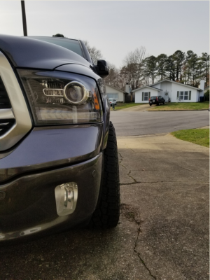

Here is mine.

Yeah, it looks like you’ve got a little bit more pokin’ out from the well than I do there.
If you’re gonna stick with them larger tires, you’re probly gonna have to either lift it or level it to get the clearance you need to get rid of the rubbing. I’m not sure about what all that lift kit consists of that you told me about but beware of just simply putting those longer links on your front levelers if you plan to get your front lift off just adding air. Do they make a leveling kit that levels the old fashioned way with spacers on top of those air struts?
