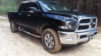

295/60/20 toyo mts stock barely rubs control arms at full lock
