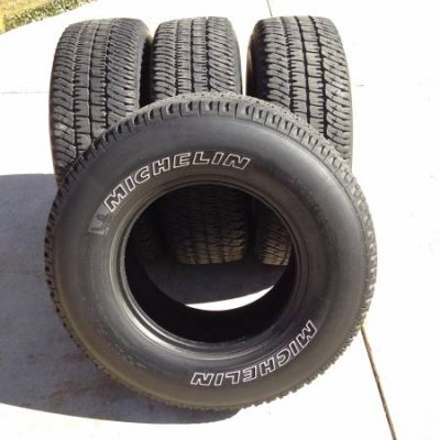

Here they are pre mount from yesterday. I'm leaving in a few minutes to be the first in line at my favorite tire store.
I know they aren't as "agressive" as some of you like but let me remind you this is a daily driver back and forth to work and will likely only see off roading by necessity or accident.
If you don't need aggressive tire's you don't need them[emoji57]. It's your money, do with it as you want.
