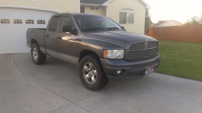

WalterG
Jul 12, 2013
892
165
Idaho Falls, ID
I have Kuhmo 325/60/20 on mine with the stock suspension. They fit ok, but they rub in turning on the sway bar.
I would like to get them off because my mileage dropped badly when I put them on. It put the RPM of the motor in the range where at 75 on the interstate even a overpass makes it downshift, so it is constantly shifting back an forth.
