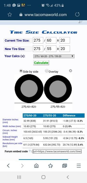

It should work just gonna be a lil less tall[emoji16]3467ad7f456022ec40fd5b3b88ba209a.jpg

I DO realize they are a smaller size, just didn't know how much "smaller" you could go before the trucks ECU threw some codes.

I had to go to 275/65/r20 to get 10 ply my only issue is speedo I off by 2 MPH over 60 MPH NO codes

I ride around on 275/55-20 full time now since modifying BellTech 2-4 lowering kit. Only issue is speedo is 2 mph off at 60 and around 3 at 80. As long as I don't think about it and compensate, traveling slower than I think so slightly less of a ticket ifI ever get pulled over.
