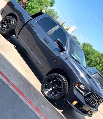

8 speed with 321 gear still lights them up from a dead stop with 35s.... I went from 35x12.5r20s to 285/75/r17
did not see any change at all. only a few inches and a few lbs but even then i dont think you will notice much coming from stock. i saw very little difference going to 35s from stock and the smile every time you lock at your truck countered it lol.

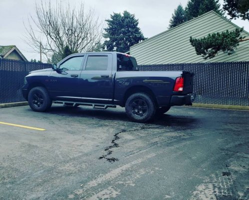

It's done, couldn't be happier. Definately need to get aggressive in removing the rest of the chrome now. 76f78a72611af31ecb3acb757f9aad4e.jpg4deb9c63250e80433c8359b22ddaf6ba.jpg504a1b237fa077c50e4bb0dff4528b45.jpg60526a0b6baf26e8ea82a18f54066563.jpg

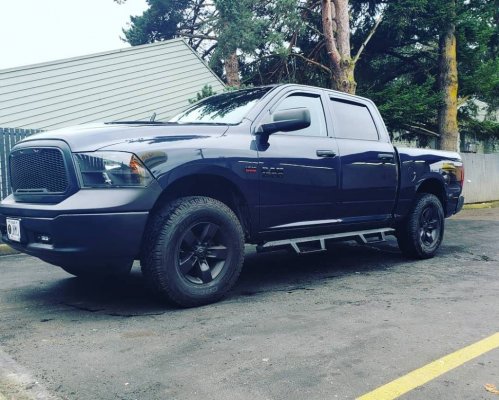

I've got 285/75/17 tires on my truck, bilsteins at 2.1. Tires are nearly identical in measurements as yours. Seeing as you have a maximum steel ram, this is my max steel all blacked out. I just have stock wheels though, plastidipped black. I will eventually get aftermarket wheel. 772927315996c2b8d5365790e05f05a3.jpgf4d356d0195d879cc4c263647f9bdfdf.jpg

Are your bumpers black? What did you do to get those? I am not a fan of any of the aftermarket front bumpers I have seen so I was considering buying some painted bumpers and having the coated satin black.

Just plastidiped, I was considering painting them so I dont have to redo them every 6-8 months, but I figure when I get rid of the truck I may have better luck if I take it back to stock. I kept all the other stuff to put back on too, like the grill.

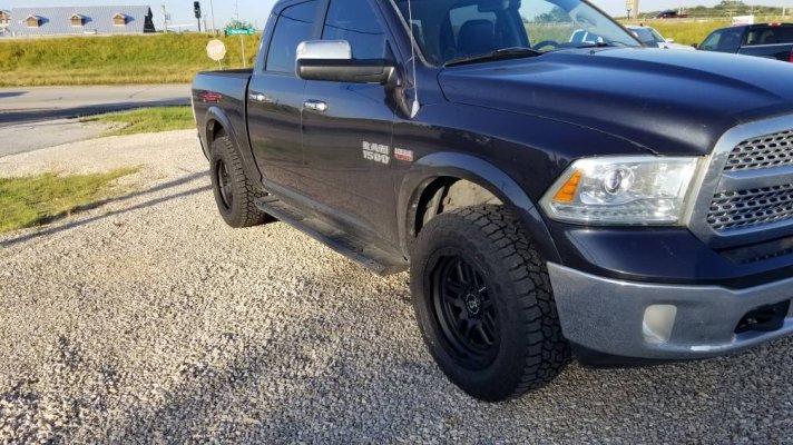

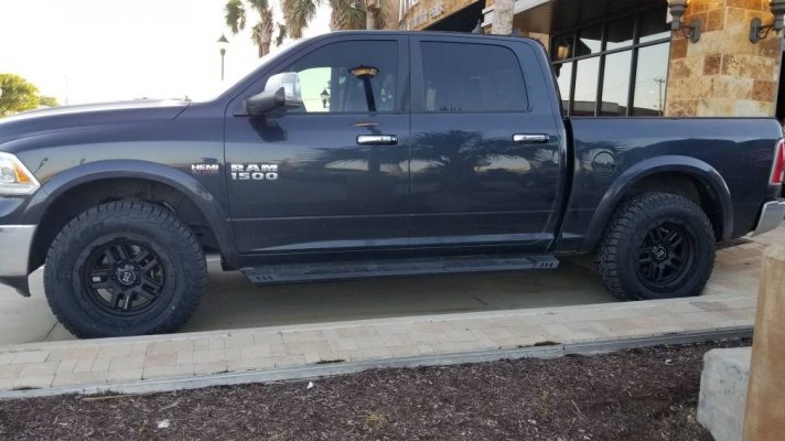

Maximum Steel Blacked out is sweet.

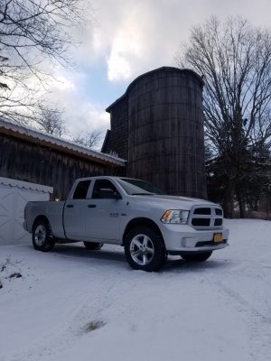

So i have a 2.5 level up front with 285/65/20 (34.9x11.2x20) they dont rub at all and make the truck sit taller and look mean without killing the power. Good luck with your choice!
