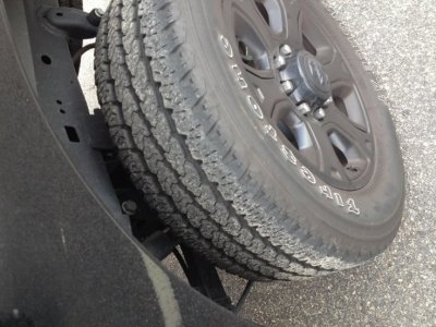

Here is a picture of one of the rear tires. It was originally a front tire that spent 6800 miles on the front. It had been on the rear for 1k miles when I took this picture.

You can see how the outer edge didn't even touch the dirt in the driveway.

Man that sucks...its pretty apparent in the pictures you posted, there "is" still an issue. What about air pressure? That dealer seems questionable if they say you can fix an issue with the alignment by rotating the tires. I only have ~ 4K on my 2500, and haven't seen any issues like this yet, but will be keeping an eye on mine now. Is yours lifted?
