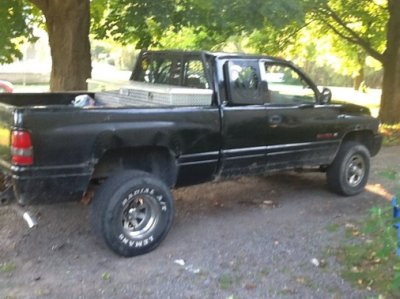

I just bought a 2002 ram 1500 4wd quad cab. I'm thinking about putting 31x10.5x15 general grabber at/2 tires on it. Will these tire mess anything up like speedometer or odometer? The 15s have a negative offset.

Here's a couple pics of the rims with old tires on my old 96 ram I sold. ImageUploadedByTapatalk1400109289.135787.jpgImageUploadedByTapatalk1400109300.836647.jpg

Could the size or offset mess up any of my suspension or effect my handling.

You have an 2002 with the new body style right? What wheels do you have on it now. As I know most 3rd gens came with 17" stock rims. It will be hard to put a 15" rim on without modifying the caliper as it is bigger than the 2nd gen rams.

I didn't even think about the calipers being bigger. I will have to see if they hit.
