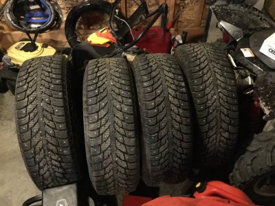

My winter tire recommendations: The best studded Nokian Hakkapeliitta that money can buy in stock size on their own steel rims...
.... but then again, my winters are probably a little different than yours.

For star Deciever I am guessing that is a great option as those are very good tires. I just purchased the Falken AT3 and am very happy with it right now as it has the snowflake on it. I have ran BFG All terrain KO2 and those worked pretty well also on my last truck.

Excellent advice on the Nokian tires. They are the best snow tires I've ever used, for all types of winter driving. Studded or non-studded. I prefer non-studded, but that's because I've had issues with studded tires. And I don't like dealing with the local laws on when you can and can't run them.
But it sounds like the OP is looking for more of an A/T tire. For that, I've been impressed with the Falken Wildpeak AT3's that came stock with the ORG. But really, any A/T tire with the 3PMSF symbol will work fine for that purpose.
