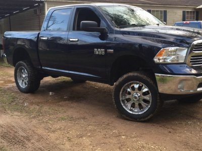

when you get a chance could you please post a pic of your truck so my wife can see how it looks? thanks

Here's a pic, I haven't ordered the new wheels/tires yet as I'm leaving to west Texas for work. This is a pic of right after I got the lift done, still had the level blocks up front so with the bilsteins is sits the same just rides a lot better. These are 20x9 and 33x12.5
