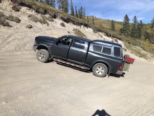

2015pw on 35s you can run 35s with no problems just need to change the tire size so you need a programer to access the computer

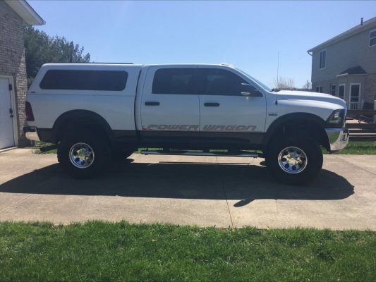

Those are the front springs I have, and I installed the Thuren Fox 2.0 shocks in the front at the same time. Drove it with the front setup and the stock rear springs and shocks for awhile. I installed the 1" rear spacers at a later date and kept the factory shocks for awhile, later updating them to Thuren Fox 2.0. I have a bed topper that has toolboxes inside the side flip up windows, carry a fulsize 37 in the bed most of the time, and still have the stock spare under it. So a little more weight than typical and thought it needed the rear spacer to keep it level. The spacer I have is not the Thuren one, but some other basic 1" rear coil spacer that's about half the price of the Thuren one.
37x13.5R17 on 0 offset 17x9. Required a moderate amount of trimming which is mainly because of the wide tires and the offset of the wheels. If the wheels had more offset they would fit a lot better.

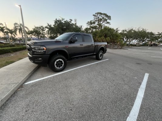

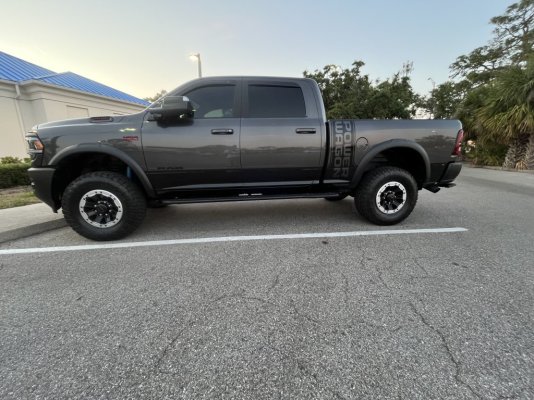

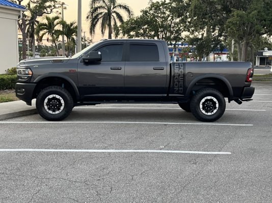

ecritz
Mar 23, 2025
Florida
Update: I went to my local off road shop (Top Shop Palmetto Florida) the owner was working Saturday morning and talked me out of a lift and advised just to go with bigger tires. Awesome shop and speaks volumes when the owner is working on the weekend and advised me against spending money. I went with 35’s and happy with my decision. Thanks to everyone for their input.IMG_2717.jpegIMG_2716.jpegIMG_2715.jpeg
