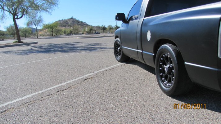

i have a 4/6 drop and i still use it as a truck. Its all in your personally like. I like the low and go look plus my two little boys can get in with no problem. With the 2/4 Hemibabe has the perfect example.

^^Thanks :)
I have the McGaughy's 2/4.5 (spindles & flip kit) with the new ram 20s.
I want to go lower, but just don't have the money to notch the frame and buy smaller tires. It's all up to how you want it

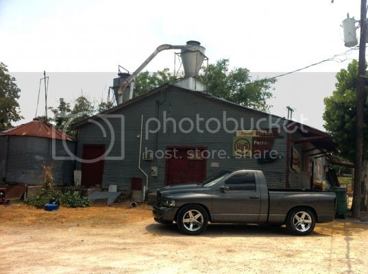

my 3"/4" drop. Best thing i ever did! love it! youll be stoked!
