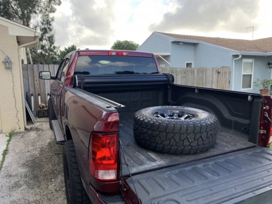

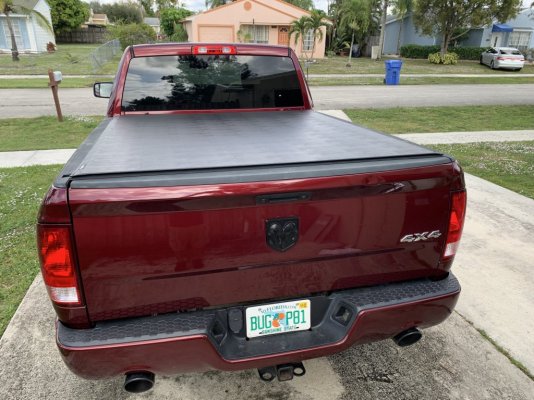

Yea. The bed is definitely tapered out. If you look at the second picture you can tell that rolled up it’s going in.
