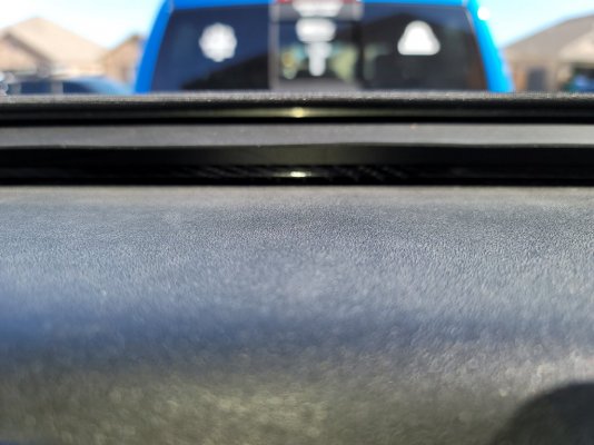

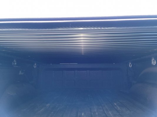

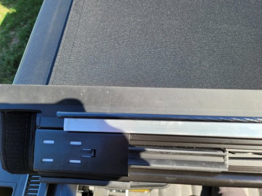

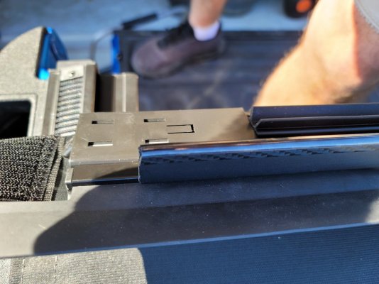

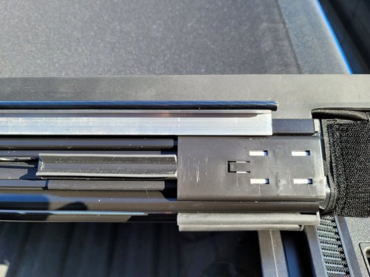

I know they are not designed to be safes, but i was able to get my fingers in and pull the cable with my finger tips and release one side, then release the whole thing in a couple seconds with my tailgate closed and locked, so anything in my bed would have been fair game. my old hard trifold would not come up and it was half the cost. dont get me wrong i love the new cover it looks amazing functions well but some one could literally steal the entire cover if time permitted, im talking to truxedo, and have installed a temp fix to stop the easy open issue.

Yeah if a theif wants in he will find a way in. the angle bar i added helps with flexing also, its aluminum, but im probably going to change to a steel angle bar. more rigidity.20211114_133927.jpg20211114_133931.jpg20211114_133942.jpg20211114_134003.jpg20211114_134023.jpg20211114_134027.jpg20211114_134033.jpg

The roll up type with Velcro would not be a very secure cover anyways, mostly made for weather proofing and aesthetics like many of them.

the cover is not snapped down and latched in the pictures, the pictures are supposed to show the added bar for security before its locked down, once its locked down there is no way to get your hand or hanger or prybar past the bar.
