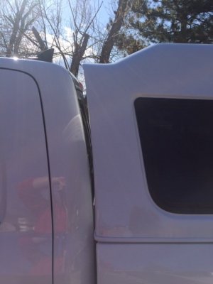

Be sure to get the proper topper fit. Here is what happened when the shop accidentally put on a quad cab topper on my crew cab. The first picture is showing my Snugtop Hi Liner on the 6.4' crew cab 1500.
The later picture is of an ARE MX model in the wrong fit, a 6.4' quad cab cut. The crewcab and megacab have a curved contour, and the quad cab is more vertically straight. A little bit of a mistake from the shop, they put on a model for a quad cab on the first go. The fit is not good.
Make sure you get the proper fit. The owners of the topper shops here in Denver are great guys and run good businesses. We got it all worked out.
