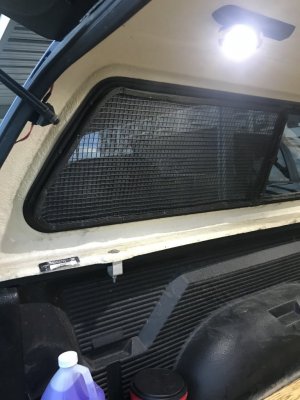

CEDBB997-AC26-4BDB-AF66-60D5A5F61437.jpeg 2DCD8340-472B-4025-9232-1BC564D8E6B1.jpeg 2EC357A0-E5D1-43DF-93A8-31163AA02395.jpeg Hi. Working on the topper area of my truck, to get ready for a trip next month. I am at a loss about ideas to cover these side windows for sleeping. My wife has plenty of material to cover them, but the angle of the windows is putting me at a loss on how to do this. Any ideas are greatly appreciated. Thank you all.

Yes, trying to make curtains. At a loss on how to attack the project with the window contour, compared to the squared off windows

To keep the curtains at the same angle you would need a curtain rod of some sort top and bottom of the window. Could be as simple as a rope/cable run through a loop on the curtains ! Or just plain Velcro stuck to the shell and curtail. won't slide but will give you privacy

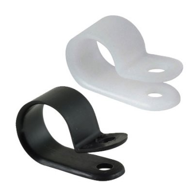

I used two curtain rods . Held them up with nylon cable clamps. Just undid some of the window screws put the clamps and rods back on the same screws and holes. If you put the clamps on going up at the top and going down at the bottom it will make the curtain just alittle bit bigger then the window and cover it..
Made the I think 4 sections of curtain for each side as the rod clamps will be in the way of being able to slide the curtains all the way from end to end. To deal with the rear part of the glass being angled , I just made the rod longer on the bottom and made the last section of curtain angled to match the window.
