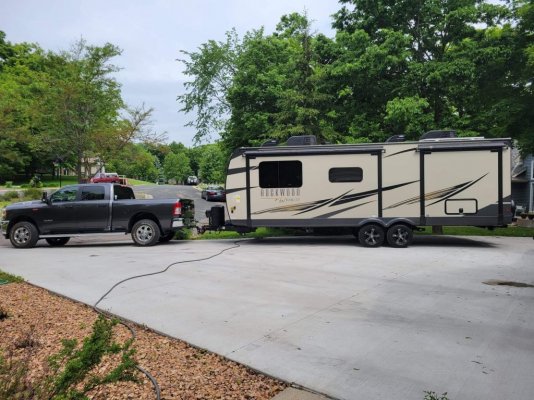

I used to have a Rockwod Mini Lite 2506. FYI Rockwood and Flagstaff are near identical and come off the same production line so our Mini Lite 2506 is the same trailer as your 25FKS other than brand badging. We were in the same boat as you as far as wanting something bigger but sticking with a TT for various reasons. We moved from the Mini Lite to an Ultra Lite 2608 - ultra lite being the next step up in size/features. The eqivilent Flagstaff would be the 26FKBS. We really love it. It's a front kitchen rear bedroom and is essentially just like what you have but bigger, with room for both the sofa/theater seats and a dinette or table and chairs. Our Gas engine 2500 tows this great and could easily tow the bigger TT's in the line but we wanted to stay under 30' and ours is 29' 8".
Weight: we have table and chairs in place of dinette, 12v compressor fridge, second AC, dual pane windows and second solar panel. Actual weight on a CAT scale on the way home from the dealer with full propane tanks and two batteries but nothing else loaded was 7,034# and tongue weight 914#. Note our tongue weight is actually less than the manufacturers spec of 946. We think this is because the second AC is in the back, behind the axles and the table and chairs in front of the axles is liter than the dinette. Our truck pulls this with ease as would probably anything in this size/weight class.
Potential issue: you dry camp wich we don't so fresh water is t an issue for us. The probl3m with this trailer is that the 54 gal fresh water tank is behind the axles so full, that would be 448# out back. We have never towed with water in the tank so I can't vouch for that. But your current TT is the sme way so you might know better.received_533665288545414.jpeg

Ratman6161, you are correct about the effects of the freshwater tank being full when towing. The next camper I buy will have a larger freshwater tank located in front of or over the axle. Not behind it!

Unfortunately, the exact location of the tanks is something you really have to dig for. It's not something the manufacturers seem to include in their specs.

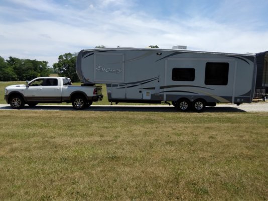

Had nothing but fifth wheels on purpose. There is a significant amount of storage in most fiver plans, so loosing the bed of the truck isnt that big of a deal for me anyway. Did NOT need a slider hitch. Most of the newer fivers have the 88 degree clearance style front caps.
