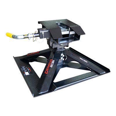

I've seen a few cases of the aluminum ones collapsing, posted on RV forums. The other thing is it uses an elevated gooseball hitch. So you get the task of raising it higher than the ball so you can drop it back down where a 5th wheel you just need to be close and it will slide in. Also with a 5th wheel hitch it is easier to see when it is lined up since it is elevated and the cargo camera is aimed right at it. If you don't have a cargo cam the 5th wheel can still be seen out the back window if you sit high in the seat.
If you want maximum weight saving and free up bed space and don't mind the ball and have a gooseneck prepped truck, go with a Reese Goosebox. They even make one with full airide and shocks suspension.
There is also a light and low space 5th wheel hitch that locks in to the gooseneck ball in the bed of the truck.
I myself went with a puck system 5th wheel made from steel for strength and durability since I haul not only a camp trailer 5er but also flatbeds with equipment.
Below is the Demco Reacon and the Reese Goosebox.
