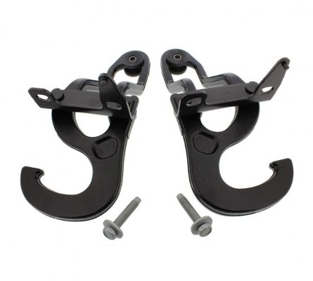

I think both of ya are correct in your own way because according to the picture- these look exactly like my Mopar hooks that my body shop got for me and put on my truck when they were putting my new bumper on. Whether you put the actual right hand hook on the left or the right side, the longer tab with the little peg on it above the two mounting holes will always be on the left side of the truck if you’re in front of the truck looking at it.
The hooks can only go on one way due to that little vertical tab but each hook can go on either side. 4807f640fc2307f57a89adac875c4d1c.jpg

The brackets that came with my OEM set were mirror imaged. Not sure what else to tell you.

Maybe it's different on different trim levels?
On mine they have to be the same bracket on both, just hooks are mirror-image.

have those same hooks, i ended up cutting off the locator tab and using them. Sent them a nasty gram and they said it was a quality issue and they would send me a new set.... new set had the same brackets. Anyways they seem just fine. I dragged my wifes durango down the driveway and they held just fine. From what I gather 18s and maybe late 17s had the locator pin location change, hence the bracket issues. Earlier trucks have mirror image brackets, mine has the 'same side' bracket location.
