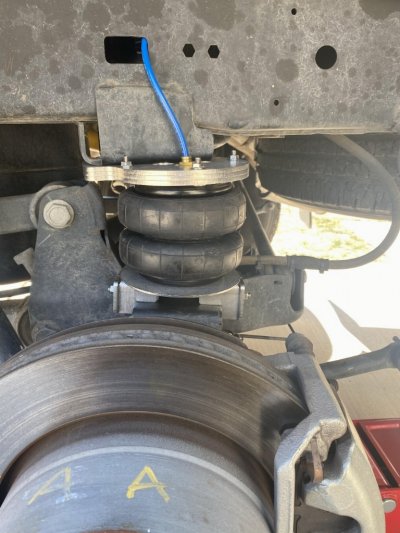

Check out timber grove airbags. These are some serious live of hardware. Dare I say make your 2500 handle 3500 weight! They are mounted outside the coil springs also so the provide more lateral stability. And at 80 psi they lifted the back of the truck about 4.5”

2018 Ram 2500 6.4L 4x4
