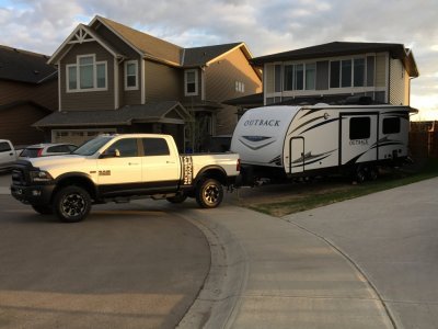

The lowered ratings for towing and payload are why we skipped the 5th wheel idea and went with a travel trailer instead. Our Power Wagon tows this one like a dream...power wagon tow.jpg
