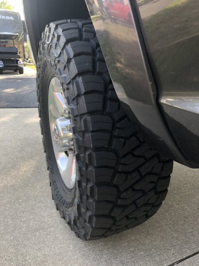

Hi,
I’ve posted here before but my initial post has been deleted (spam??)
My 2023 power wagon had tires replaced by low cost tires (advantage ATX-850) and I had vibration in the cabin at highway speed (I see the passenger seat back rest shaking)
The truck has 35k miles only, suspension seems to be ok.
I was convinced that vibration was caused by the tires and yesterday decided to upgrade to Nitto ridge grapplers (35x12.50xR17), had them road force balanced. I was monitoring entire process, these are my road force balance results:
FL wheel with 12lb
FR wheel with 19lb
RL wheel with 29lb
RR wheel with 35lb
Minimum weight added (< 2oz top)
Both right side wheels required tire to be sniped in the rim, specially the RR wheel adjusted in 4 positions but still final possible results is at the limit set in the machine (< 35lb)
The technician said it was caused by them rim (??)
Final Result: same f**** vibration after spending $1800 in the new tires.
Now, I’ll schedule a ram dealer suspension/shaft/axle inspection to make sure I eliminate other possible causes.
Any thoughts/experience to share? Can I just have a faulty tire(s) and would have fight discount tire replace them?

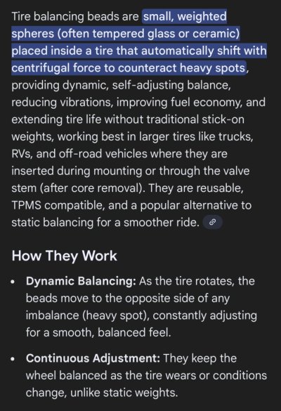

I throw in balance beeds when my tire start feeling ******. Solves my issue every time.
Dean2
Jun 17, 2021
4,455
8,947
Near Edmonton
2021 2500
I tried the balance fluid once. Really bad idea, makes fixing a puncture nearly impossible. I never tried "Balance Beads". What are they and how do they work if you don't mind saying.
Airmousam
Jan 13, 2021
384
340
new Hampshire
Interesting! Are balance beads a thing on trucks like a PW? I've used them with success on high-performance modified street bikes mainly to not see the weights on the wheels...thx

So, @SPetri - any updates on getting your tires properly balanced?
@olyelr - thanks for the explanation. Looked them up, Fountain Tire near me installs them. I am going to give balance beads a try, looks like and excellent way to balance large tires on a 4x4.
