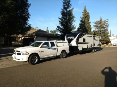

Here is my 2014 ram 2wd 1500 with 6 speed trans and 3:92 gears hooked up to my 8800lb travel trailer.
I have no issues pulling this trailer.
Factory tow package, AIR LIFT 1000 inflated to 35psi.
I only upgraded my tires and shocks when the factory oem was due for replacement.
Never any issues towing as long as I kept it at safe speeds for the conditions I was in at the time.
I was leaving for a 2 week trip when I took this picture and took this opportunity to weigh my rig as I knew I was fully loaded. I usually am not this heavy for my normal weekend trips.
3300 on my front
3900 on my drive
8000 on my trailer
Yes I was 300lbs over on my truck but still within my axel capacity’s on all axels and still under gross combined.
However I have since upgraded to a 2500 4x4 Laramie. This was just a want, not a need for me.

What model TT is that? My son has a 2018 Imagine 2670MK. It weighed about 8000lbs loaded but the specs say 6600lbs dry weight
