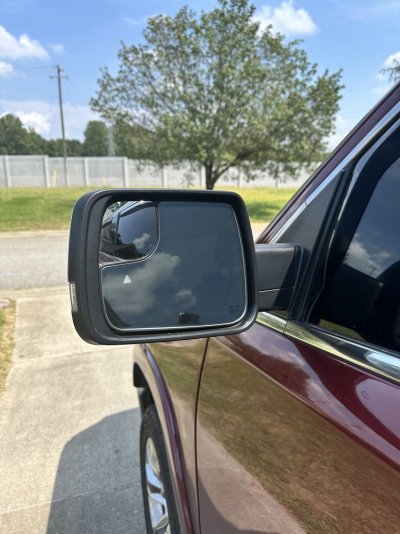

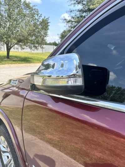

This is my 2019 Laramie Longhorn and it has the regular mirrors. They are power folding.
