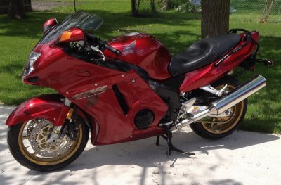

2) While riding my CBR1100xx Super Blackbird in Vermont with a buddy on his Beemer 1200 we came upon a Ford F-250 pulling a 30ft cabin cruiser on a tandem axle trailer up a hill. It was a pretty big boat. We passed him no trouble doing 65mph. He then catches us on the down grade and we continue opening the throttle to stay ahead of him. In short order we're over 75mph and pushing to 80 in a 55 zone. He's still coming. He tailgates me going down hill at 85..and I let him pass and get way ahead of me. Granted, we're running up and down hills so I guess he's using the down grade to carry momentum for the next hill climb. But holy crap...he would never have gotten that thing hauled down if he needed to in a emergency situation. I think the boat would have ended up in the back seat of the cab, or coming out the front of his skull! We decided to let him go and we sat back waiting for the accident to happen (it never did).

Haven't seen a Blackbird around here for quite awhile sadly. Always liked them, but never owned one.
