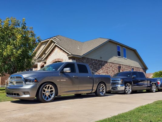

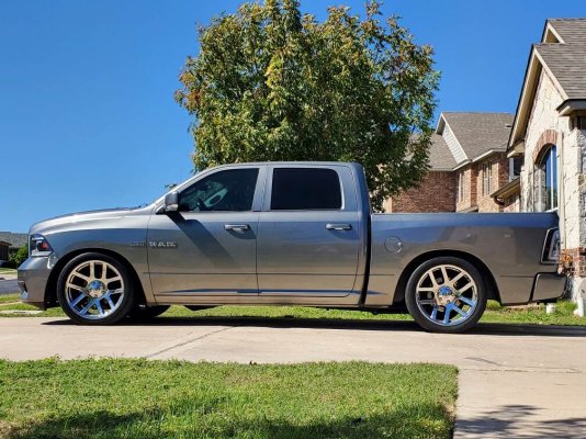

I have an 09 Ram 1500 with 5.7L with 6 speed and 200k miles. Truck has long tubes and a hemi fever tune, so she's peppy but not fast. I finally lost 4th gear in it and I'm left with choices. Looking for some advice or any other creative ideas.
1. Get trans rebuilt and keep on moving a long.
- leaves me with high mileage motor and meh trans compared to an 8hp style trans
2. 8hp swap it
- leaves me with a high mileage motor that needs a refresh in the near future
3. Buy a 5.7l with 8hp and swap that in with some mild upgrades, mostly a cam and the while you're in there's.
- leaves me with a case of the shouldas, shoulda swapped in a scat pack motor
4. Buy a scat pack setup and swap it in with some mild upgrades
- leaves me with the wife complaining that I should of bought something new and worse gas mileage
I haven't done much research and how many cans of worms I will be opening with each approach. Was looking for thoughts or ideas on what direction to take from those that might of gone down this road.
Attached are some pics of her.

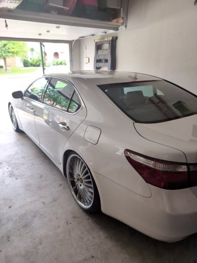

This is my backup when the truck goes under the knife. I'm an ok DIY guy one of my boys is swapping a CTS-V motor into a 96 Impala and doing all the wiring himself. I'll probably call on his crazy @$$ to help or I might pay him to do it since he's been laid off.
I think my pipe dream is the scat pack, realistically a 5.7 refresh with SGA 8HP swap. Maybe a cam at the same time, it would be nice to hit 450 ish HP with the 5.7 but I know I'm asking for way to damn much.
