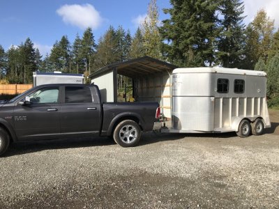

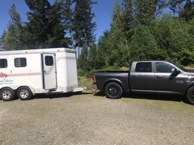

My experience with a 2 horse trailer has been pretty positive, I have a 2017 Crew Cab 4X4 Hemi with the 3.92 rear end. First two times were hay runs and truck did just fine. Last weekend acted as horse Uber, hauling 4 horses (2 trips) with a different slant trailer. Tack room was lightly loaded, no hay and the rental trailer did not have a water tank.
My truck is NOT leveled. The hay runs were on the stock Goodyears, now have Toyo Open Country AT2 in the stock P-metric size.
If anything I would prefer a weight distribution hitch, if we buy a trailer will add for sure

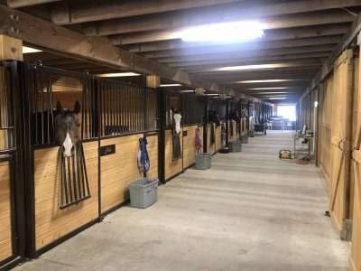

The barn owner is renovating everything. He is the best finish carpenter I have ever seen, so every thing he does looks fantastic. We are fortunate to have our horse stabled there.
Have always enjoyed seeing well made, large stall barns that are comfortable for the horses and easy to maintain. Thanks for the pics

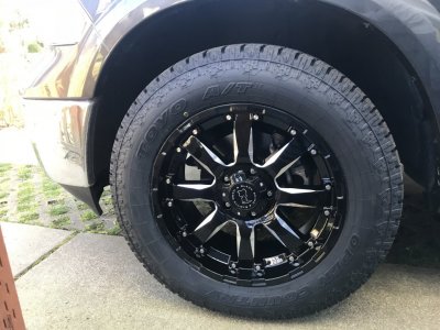

Love the pics of the trailer loads. That is what my setup is like as far as size. Your black wheels are NICE! So I bought the Equalizer so I can hook it up to the trailer I plan to "borrow" for my next few trips. I plan to upgrade the springs right away since the cost is reasonable for a safe upgrade and I'll look into the TOYOs next year once I burn some more tread off these. Super happy I've got the right truck for what I need to do.

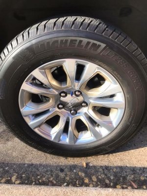

I’m running :
Michelin lt 285/60/20
Air lift air bags
Hellwig solid sway bar
12,000 lb load equalizing hitch
I’m towing a 9750 gvw travel trailer
I take my time. What I did made a big difference . Its not like I tow daily .Yes I know it’s 2500 territory , I’ll be making that purchase in the spring when I can write a check for the purchase . Hope this helps
