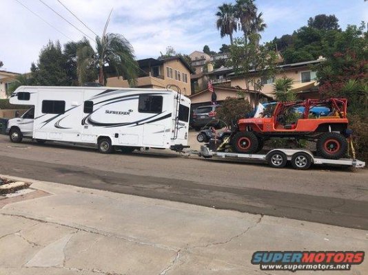

so the wife and I are wanting to do an excursion in March for my kids spring break in our 32 foot class C RV.
Usually when we take the coach out we are pulling my heavily lifted and modified Jeep Wrangler on an 18’ aluminum flatbed trailer behind it as we have pretty much exclusively used it for desert boondocking for wheeling weekends since we have owned it.

As for the weight, part of the reason we bought this particular RV is because it has a 7,500 lb tow rating. That package pictured above comes in right around 6,500 lbs. the aluminum trailer only weighs 1300 lbs and the Jeep is about 5k. I have also hauled my Ram on that trailer before behind the RV. Felt a little more sluggish than with the Jeep, but it pulled it quite well on the trailer. I would imagine pulling it four down without the extra weight of the trailer would be no problem.
