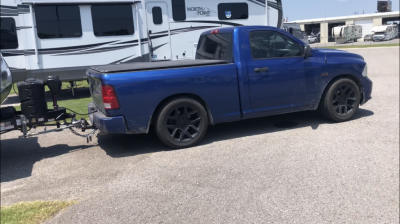

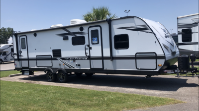

Was a video, just screen shot so you could see. I’m sitting on a 2/4 belltech kit with the Airlift 1000’s in the springs. This was my second travel trailer pulling after lowered, both were roughly 32’ from hitch to bumper and weigh around 6700 lbs. I work turnarounds and travel a lot for work, usually 200-400 mile tows between jobs a few times a year. I never had any issues at all towing. Get a good weight distribution hitch, trailer brakes, Airlifts are a MUST, stay within your trucks towing capacity, and don’t drive 80mph and you will be good. E0968B75-827C-48F9-9772-DF6F4867E922.png 6B556667-29B5-4151-BCBC-9BA74AC4419D.png B4955CC2-5D8B-4A7C-8914-32B444FF9C55.png
