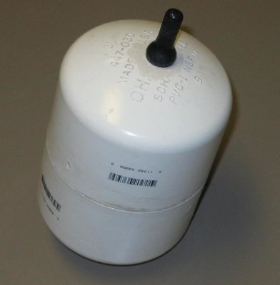

Remove sensors, build pvc tube, insert sensors, fill to 35 psi, zip tie to frame of truck. Cost you more to remove the sensors from the wheels than to build the pipe with shraeder valve.
