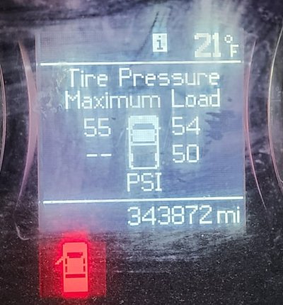

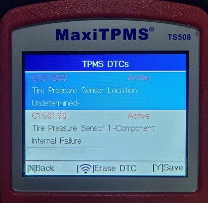

I have been fighting a TPMS issue where I loose one of my sensors in the display and get the TPMS light on the dash. I used my Autel TPMS tool to get codes and I keep getting the same C151D-00 & C1501-96 codes. I already replaced the sensor in the tire and keep getting the same code. Does anyone have experience with either these codes that can help point me in the right direction?

May be a bad TPMS module.
I also replaced the TPMS module with a rebuilt one and had the exact same issue. Its possible the rebuilt one was defective, and I did not confirm that the codes were the same before and after, but the problem followed this now rear left wheel's sensor.
Was the replacement sensor and OEM or aftermarket? Was it initialized after installation?
I run Autel-MX sensors in all of my vehicles. I did initialize the sensor and when I perform the position relearn I get pressure from all 4 sensors for the first 5-10 min of driving. At that point the system must do some kind of check prompting the issue that I current have.

Update: after driving some miles the new sensor appears to be working. So those codes appear to indicate that the sensor that was not reporting was in fact bad and needed to be replaced.
