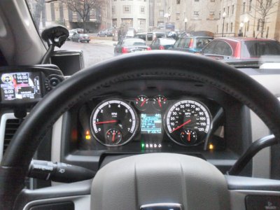

Ya, two lights, ABS, and the squiggly car light. It isn't really an issue if you know why they are there though. I pretty much forget about them while driving, and if you ever loan your truck out, popping the fuse back in is easy. I even store the fuse I pulled IN the fuse box lol.
