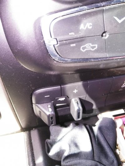

Underneath your heat controls should be a brake control switch, which allows you to adjust the Gain when a trailer is hooked up. If you don't have this, then you don't have trailer brake controller.

it looks similar to this
BrianandChrissy
Jul 11, 2016
826
477
Buffalo NY
2016 big horn crew cab
5.7 hemi, vararam CAI

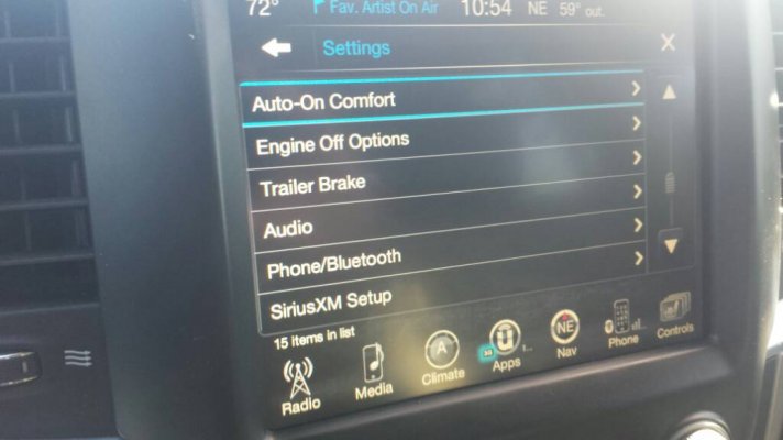

Thanks for the info. I had an OEM trailer brake controller installed. Now I have a different and question. Since The service department has been NO help. I thought I would ask the question here. The owner's manual refers to go into settings and then go to trailer option where I can choose from one of 4 preset options on the controller for the type of trailer I have. My touch screen did not have this option prior to installation nor after the installation. Was the service dept. suppose to upgrade my settings or is there something I am suppose to do to upgrade my setting for this option?

Did the dealer add sales code “XHC” to your truck?
Jimmy07
Feb 23, 2017
3,507
3,548
Did you have the dealer install the brake controller? If so, you need to call them and ask them if they added sales code XHC to your truck. The controller itself will still function, but that sales code is what makes the settings appear on your screen to fully “integrate” it with your truck. It sounds like they either didn’t do it, or did it wrong. Either way you need to ask them.

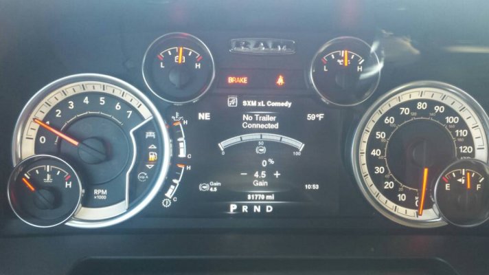

If your trailer brake was installed correctly and the code was added in order for it to come up on your speedometer screen all you need to do is slide the controller and it'll automatically flash on the speedometer screen. I have a 7-inch screen so this is what mine looks like but it will also flash up if you have the smaller 3.5 inch screen. In order to adjusted you go into to your settings menu where you should have the trailer brake control option and then when you push on it it should show your four different configurations that you can store. If you don't have the trailer brake in your settings menu and it doesn't pop up on your screen when you slide the brake controller then either they did not flash the code or there's something wrong with the install. The whole unit basically just plugs in so there's really no way they could have screwed that up as long as they plugged everything in then as stated they most likely did not get the XHC code to set. I would recommend taking it back to the dealer and having them verify the code is set and check their installation because yours obviously appears not to be activated or working correctly. On a positive note once you do get it up and running they work great. I have been very happy with mine and I like the fact that I can store different trailers that I pull.4476e875435480eaa23ff838b5c9270e.jpga1fa9787dba43c88e25eece7867528a8.jpg00ab29d34a43a57ce86e444fb5067233.jpg

If you haven't had the flash done once you add a oem trailer brake controller nothing will be on your radio settings. After I installed my oem trailer brake, I went to dealer, had flash done, that added the trailer brake option on my evic. Then when I went home I had to put my radio update usb stick in, the system automatically found I had a trailer brake added and updated on own. Then I had trailer brake option under settings. Really dealer should do that when flashing, but luckily they didn't because I put a 2015 8.4an in my 2013 truck. Aftermarket trailer brake is simple install. There's harness that costs about $14 and just plugs into aftermarket controller and you mount under dash. I used that for last year then found a oem trailer brake controller box on ebay for $60 so installed that.
