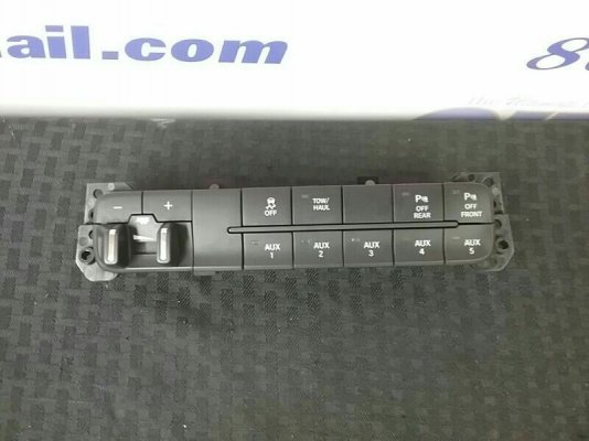

I might be wrong here, but i believe that whole entire section (the heated/cooled seat switches and the flat black plastic area you pointed out) are all one big part with 1 plug in the back. Im pretty sure there are a ton of different part #s available because of all the different options available in the trucks.

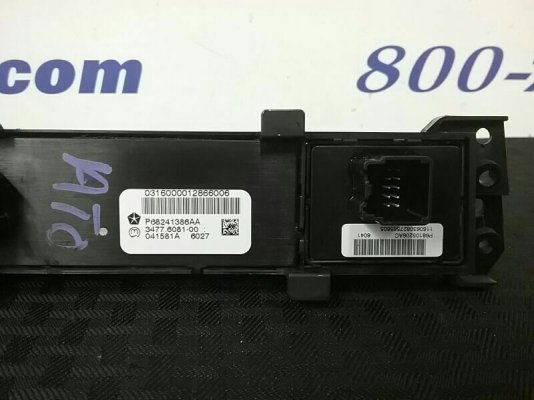

The trailer brake controller pops out of the plastic "bracket" i guess you can call it.
It is a completely separate piece that can be ordered on its own.
As you can see in your picture, it has its own barcode and PN.
This was my findings in all the diagrams I looked through as well.
Can order just the controller by itself, but not the plastic delete panel to replace it.
Kinda odd, you would think the parts diagrams would show the plastic cover for those people that do not have the controller, or someone that removes the factory controller.

You are correct that all the little switches are together on one module, with the exception of the brake controller.
