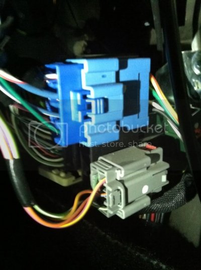

I know there are a couple DIY threads on installing the OEM controller, but for some reason I couldn't seem to find the ones with really good pictures. I need to rig a brake controller in my truck for a couple days, and am borrowing one from someone.
Could someone shoot me a photo of which plug under the dash is the TBC plug please, because I am just going to use some blade connectors to plug it in.

Are you doing aftermarket or the integrated one? The place you plug the pig tail into is blue if I recall.

I am familiar with that connection, but I am pretty sure in 10+ they put a different plug under the dash as I do not recall seeing the blue one you posted. That blue one has been used since 2nd gen ish if I recall.
I am planning on using a prodigy p2. I don't like the poor adjust-ability of the integrated controller.
Thanks for the reply, and awesome pictures though!!!

Yeah I think you have the square gray connector on the newer models. I was looking at them on etrailer.com and they are a lot different.

I figured it out with a DMM, and got it all hooked up last night.
It kind of threw me for a loop though when I couldn't find the switched brake wire... Then I realized my ignition wasn't on, and in the 4th gens(?) no ignition on means no brake light apparently lol. Once I figured that out it was all smooth sailing.
Hey though, what is that five pin gray connector right next to your trailer brake plug?
